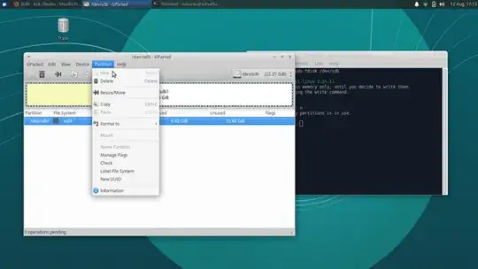

First I tried fdisk, I tried
fdisk /dev/sdb
linux is installed in this ssd
then I hit 'n' and it says: all space for primary partition is in use And I can't do anything after that.
Then I opened gparted and tried to create a new partition that way, and the new partition option is grayed out. enter image description here I'm running from boot media, because I heard you can't edit partition while it's mounted.
I have no efi partition from my previous windows installation. And I can't boot Xubuntu without a bootloader The ssd is MBR. Can I create an efi partition on my HDD, a separate hard drive and will it work from there? Because I'm able to create new partitions from the hdd. But oddly not from ssd why?

From the screenshot, it looks like you're trying to edit the USB disk (6GB used + 16 GB free = 24 GB total) on which Ubuntu is installed.
Even if it would be an old and very small SSD, trying to change the partitions of an OS that is currently running on it would be similar to try and perform an operation on yourself, in your living room with a kitchen knife.
Dear patient, please go to the operating room and boot Ubuntu Live from another USB stick and perform a sterile operation. ;-) (Follow the duplicate, please) Posting this as an answer as there is not enough space in the comments...
