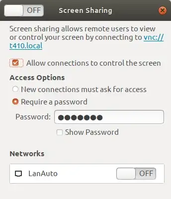

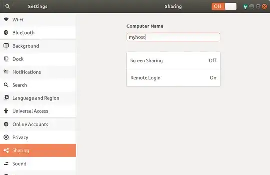

Controlling current desktop currently is a standard feature of Ubuntu
It is called 'desktop sharing'.
VNC server is installed by the vino package and his setup available in the gnome-control-center sharing
See Cannot turn on sharing on ubuntu 18.04
sudo apt install vino
gnome-control-center sharing &
