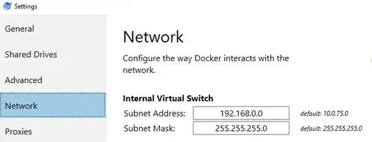

This docker support forum has various answers to check out:
The easiest answer (not guaranteed to work for you) says:
I changed the subnet address on docker settings to match my wifi ipv4 address and it worked for me.
Even if this doesn't solve the problem you should read the whole thread and search the rest of the docker forum for similar questions.
