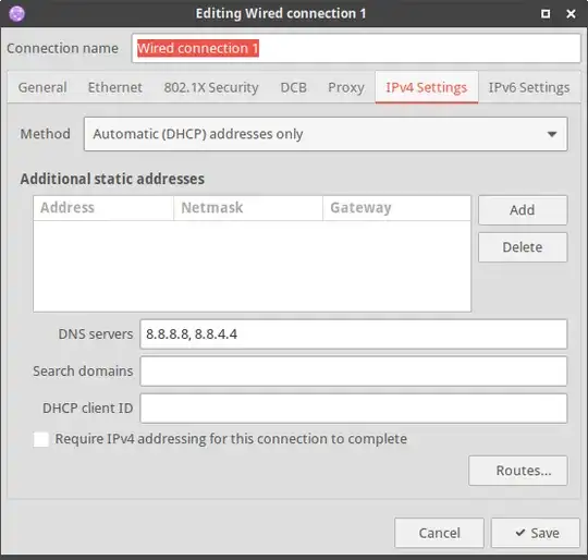

These are my connection's settings: Ethernet connection settings

I suggest that you recreate the missing netplan file; from the terminal:
sudo nano /etc/netplan/01-network-manager-all.yaml
Add the following:
network:
  version: 2
  renderer: NetworkManager
The spacing and indentation are critical and must be correct. Proofread carefully twice. Save (Ctrl+o followed by Enter) and exit (Ctrl+x) the text editor. Follow with:
sudo netplan generate
sudo netplan apply
Next, in your case, resolv.conf is not pointing to systemd as expected. Therefore, I suggest that you remove and recreate the link:
sudo rm -f /etc/resolv.conf
sudo ln -s /run/systemd/resolve/stub-resolv.conf /etc/resolv.conf
Reboot and tell us if there is any improvement.
