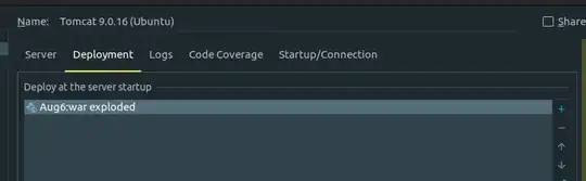

Another important thing is: In the Deployment section, make sure to add Artifact like this: Screenshot of Tomcat Config page
