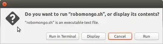

If you have checked the option Ask each time for the Executable Text File in the Nautilus Preferences, then you will have two options Run in Terminal and Run, when you (double) cluck on an executable by the mouse:
You need to choice Run to achieve what you want. This is also the default behavior if you have set Run executable text files when they are opened in Nautilus Preferences.
