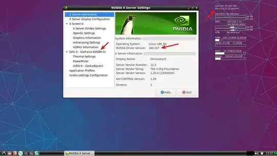

This screenshot shows a test system of mine running the 5.0.0-23 kernel.
It has an Nvidia GeForce 8200M card and is running the 340.107 driver from the graphics ppa.
(This happens to be a 19.04 system, but it's running the same kernel as the new one in 18.04 LTS HWE. It's a 64 bit Ubuntu system with the LXDE desktop installed.)
