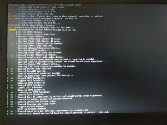

After that I restarted my Ubuntu and now it is failing to boot, with the following error:
Boot screen error
After that I went to Console 4 (Ctrl + Alt + F4) and tried to start Network Manager (which was the failing service) using systemctl start NetworkManager.service but it failed to start it. The output of journalctl -xe mentioned the cause as follows:
/usr/sbin/NetworkManager: relocation error: /usr/lib/x86_64-linux-gnu/libgnutls.so.30: symbol _idn2_punycode_decode version IDN2_0.0.0 not defined in file libidn2.so.0 with link time reference
exit code: 127 When Ubuntu boots up, NetworkManager.service fails to start.
I even removed the packages I installed (autoremove --purge), but it still didn't solve the issue.
Because of all this my Ubuntu machine is not booting. I am guessing that the symbolic link is the issue. What should the symbolic link be?
