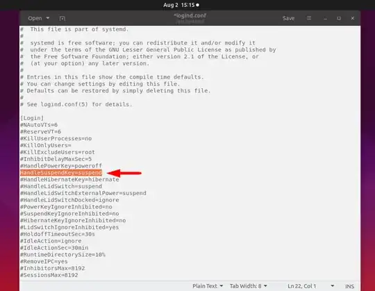

In Ubuntu 18.04 Gnome desktop, there’s no option in Settings utility for configuring laptop lid close actions. And Gnome Tweaks only offer a switch to enable/disable ‘Suspend when the laptop lid is closed.
Follow the steps:
  • Open Terminal
  • Paste the following command in the Terminal sudo gedit /etc/systemd/logind.conf
  • Provide your system password if it asks.
  • Now you need to find the line #HandleLidSwitch=suspend & uncomment it (Remove the # from the beginning).
  • It will be like the below image: enter image description here
  • Save and exit the file.
  • Now restart the Systemd service using the following command: systemctl restart systemd-logind.service
That's it, This method will fix your issue.

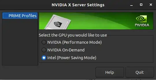

I was also facing the same issue. So you may have switched to Nvidia graphics drivers. If that's the case, just switch back to Intel and restart.
Nvidia X server settings
