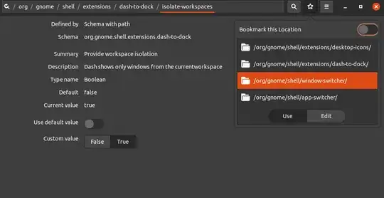

dconf-editor
in Ubuntu 20.04 LTS,
dconf-editor seems powerful (than gnome-tweaks)
and easy to use (than gsettings or dconf).
the workspace related options:
  • /org/gnome/shell/extensions/dash-to-dock/isolate-workspaces
  • /org/gnome/shell/app-switcher/current-workspace-only
  • /org/gnome/shell/window-switcher/current-workspace-only
Run dconf-editor, press Ctrl + L to input location path.
screenshot:
