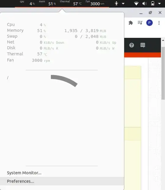

Try installing this extension sudo apt install gnome-tweaks gnome-shell-extension-system-monitor after executing this command logout and login again and after that see that the app named extension is added to the show aplication list and enable system monitor in the extension appenter image description here.After that a system monitor tab will be added to the top open it and select preferences and search for fan and select display it.Hope this help.enter image description here
