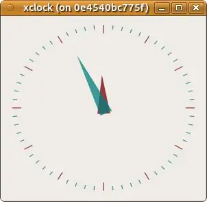

We need to inform container about running X11 server on host with special syntax [1]:
docker run -e DISPLAY -v /tmp/.X11-unix:/tmp/.X11-unix --user="$(id --user):$(id --group)" ubuntu:xclock
xclock on docker
