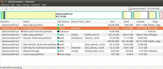

Use sudo gparted and this screen shows up:

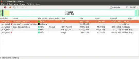

From the menu pick GParted -> Devices -> /dev/sda (or whatever your hard disk is called).
Then gparted refreshes with the other drive's partitions. In my case like this:
Note: This 1 TB hard disk has 919 GB usable. Only 42 GB is used because when it was a brand new laptop and the first thing I did was put in an SSD and never used Windows 10 on the hard disk. I plan to use it for backups someday.

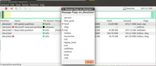

Now select Partition->Manage flags and this dialog box appears:
Check the box next to boot flag.
