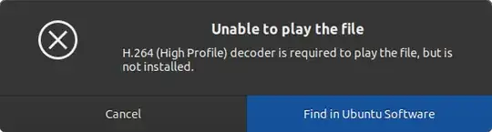

I have a fresh install of Ubuntu 19.04 and I am unable to play a MP4 video in Totem. Following the suggestion to install the necessary decoder was unsuccessful. Which codecs must I install to play this video file, which uses a H.264 (High Profile) video codec and a MPEG-4 AAC audio codec?
During the install I checked the box to install third-party graphics software and additional media formats:
installer options screenshot
I have the main, universe, restricted, and multiverse repositories enabled.
I have multiple gstreamer packages and codecs installed already:

I note I can play back the video file no problem by dragging it from Nautilus into an empty Firefox or Chromium tab, but Totem will not play it.

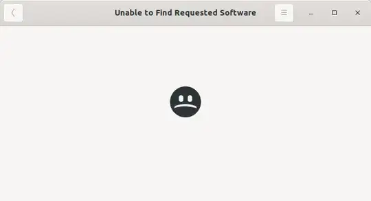

When I click the "Find in Ubuntu Software" button, Ubuntu Software displays the message "Unable to Find Requested Software" (This last bit is probably a bug but I don't mind, I just need to know which packages to manually install). Any suggestions please? How do I play this file in Totem on a fresh 19.04 install?
Totem error screenshot
Ubuntu Software error message
Edit: Upon further troubleshooting, I have discovered that Totem will play the same files if they are in MKV container format instead of MP4. I use youtube-dl (latest version, not from the repos) to download BBC iPlayer videos. I can set the --merge-output-format mkv option and play the downloaded file. Without that option it outputs to an MP4 which I cannot play. This is an OK workaround, but I'd love to know what exactly is interfering with MP4 playback and fix that.

Tom Brossman
  • 13,297
Something wrong with gstreamer1.0-vaapi First make a simulation, please. apt --dry-run purge gstreamer1.0-vaapi because of dependencies.
nobody
  • 5,792
I had a similar issue recently and installing gstreamer1.0-libav fixed it.
Using totem 3.34.1 a dialog popped up to search Ubuntu software for GStreamer Multimedia Codecs.
After installing the GStreamer plugins from the "bad" set version 1.16.2-2.1ubuntu1 from the category Add-ons → Codecs, totem was able to play the avi.
