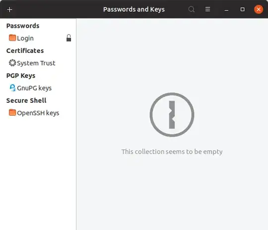

This didn't work either. In Libreoffice, I can see an option to start a certificate manager. When I click, I get the following window.
I can click on the certificate in the cert directory but the open button is not clickable.
How can I get either word processor to find the certificate that I created in ~/cert, or is there something wrong with the steps I used to create it?
