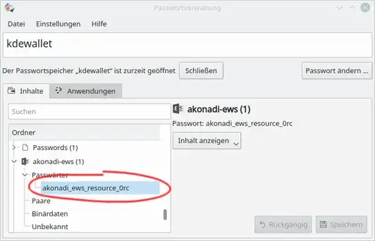

With the resource name, you can add a password entry in kwallet for "akonadi-ews" using the resource name and append "rc". For example a resource "akonadi_ews_resource_0" gets an entry "akonadi_ews_resource_0rc":
If you create a password like this, it is saved and used by KMail/Kontact.
(Sorry for the german locale in the screenshots, I hope the intention is clear.)
