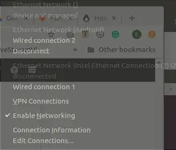

EDIT 4:
ping 8.8.8.8
connect: Network is unreachable
ping www.ebay.com
ping: unknown host www.ebay.com Also, this is what I see now in the network section (I use tethering in order to have internet access for now)
