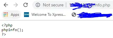

I`ve installed php 5.3.24 in my UBUNTU 18.0.4 but unable to show info.php page

PLS Give any suggestion
Is UBUNTU 18 is compatible with php 5.3.24?
