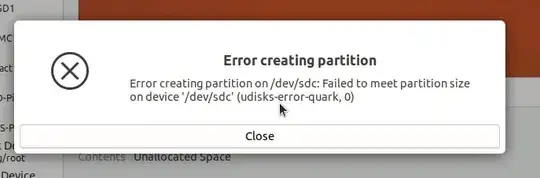

When I tried to create partition using "Disks" software, I got the error, that I have not enough free space in computer.
Image of error
I have also uploaded a video on YouTube to explain my problem deeper. I'm using Ubuntu 19.04.

you should probably not be using "Disks" to attempt to partition your HDD. Disks is a simple mountpoint management tool which is really handy in it's own cases but not for formatting.
Gparted is unanimously regarded as the go-to formatting and partitioning tool on linux.
You can find Gparted in you Software Center.
In Gparted, every action yo take needs to be "applied" so be sure to click that green check mark to see your changes take effect!
Also don't choose MBR (in the video I can see your drive is only 1TB not 2TB, so MBR should function for this drive yet this technology, the way I see it, is outdated).
You should choose GPT. GPT replaces MBR and is far better. Most importantly it absolves you of the need to have master and slave partitions. you can have as many primary partitions as you want (128 to be exact) and in no particular order.
