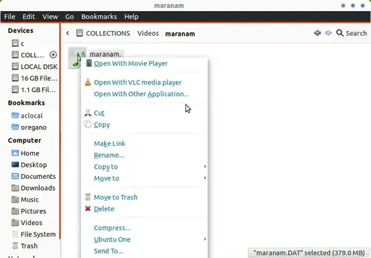

I am trying to open .dat files from a vcd but can not open them. Help please?

Install open the terminal and type
sudo apt-get install ubuntu-restricted-extras
then open with movie player(totem)
Or install vlc media-player
sudo apt-get-install vlc
