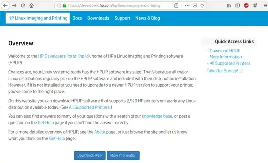

Your best bet is to ask HP to release an application similar to Windows for Linux. This is a good place to start:
In this Ask Ubuntu question it is asked:
  • What should one install to make Ubuntu fully support the HP printer and/or scanner?
The answer there is to use:
sudo apt-get install hplip hplip-gui
However the full answer is more complicated than just the simple command
