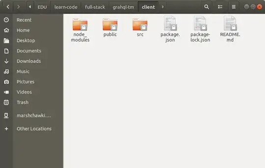

I'm new to Ubuntu and I'm trying to delete some of my files but I get a message saying "Permission denied", and my files are locked. How do I unlock them to delete them, or make changes?
![pic of locked files]](../../images/1422ef54cb2cfbe5a05517d28c0333f6.webp)
You may not be the file owner of these folders and files. They may have been created with root access, which a user would not be able to perform modifications.

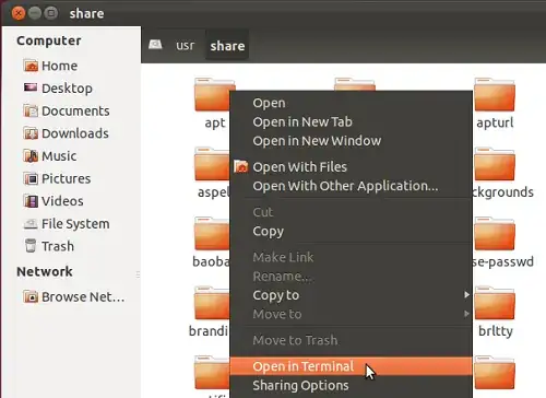

You can verify this by opening a terminal in that folder by right-clicking on empty space in the folder and selecting "Open in Terminal" :
You may then find out what the rights and ownership are by typing:
ls -alF

Let's take a look at basic file ownership.
Here's a file that I own. I can change it or delete it because I own it:
$ ls -l testfile
-rw-r--r-- 1 frank frank 0 Jul 5 07:12 testfile
//Owner is "frank", Group is "frank"
Let's change the ownership. Let's give the file to the user 'helen':
$ sudo chown helen:helen testfile //New owner is "helen", new group is "helen"
$ ls -l testfile
-rw-r--r-- 1 helen helen 0 Jul 5 07:12 testfile
//See how the ownership has changed?
//When owned by helen, I cannot change or delete the file anymore.
//The lock appears in the GUI icons.
Let's change the ownership back to me, so I can make changes and get rid of the lock icons:
$ sudo chown frank:frank testfile
