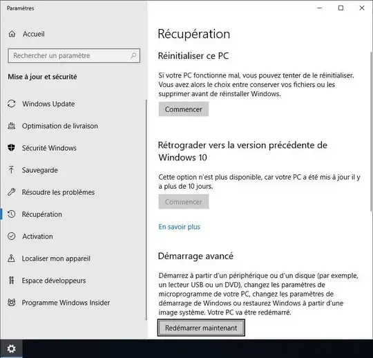

now you may open up "reset" from start, this will open up the settings as below:
windows settings
choose "restart now" this will allow you to choose what boot media you want to restart to.
Once you restart you'll be greeted with this screen (click "Install Ubuntu"): reboot select media

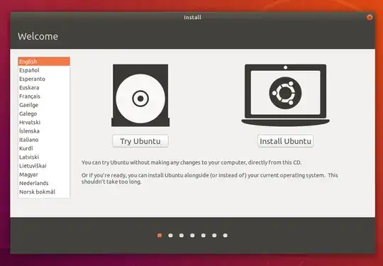

once you've booted on the USB you'll be greeted by this screen:
ubuntu install greet screen
at this point you'll be able to follow the steps they are pretty intuitive
