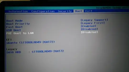

enter image description hereAfter a series of unfortunate events, I was finally able to install ubuntu 19.04 in my Lenovo Legion Y530. I had to install the OS for like 10 times after erasing the last ubuntu installation again and again. (after erasing the preinstalled windows 10 for the first time) and in Legacy Mode. Now the problem I am facing is the following:
When I start the machine, after displaying Legion logo, the following message comes:
Intel UNDI , PXE 2.1 ....Realtek PCIe GBE family controller series v2.66...
PXE-E61: Media Test Failure, check cable. PXE-M0F: Exiting PXE ROM.
After that, it shuts down, starts again and loads ubuntu properly

re: "PXE-E61: Media Test Failure, check cable. PXE-M0F: Exiting PXE ROM."
The Preboot Execution Environment (PXE) is an industry standard client/server interface that allows networked computers that are not yet loaded with an operating system to be configured and booted remotely by an administrator.
This means that your BIOS boot order is incorrect. If you look at the current boot order setting, you'll find that PXE boot comes before CD/DVD and HDD/SSD.
Your boot order should look something like:
  1. CD/DVD
  2. HDD/SSD
  3. USB
  4. PXE
Update #1:
Your boot mode/priority AND your SATA controller should NOT be set to legacy. Secure Boot and Fast Boot should be disabled.
Update #2:
Check your BIOS version, and update if required. Boot to a Ubuntu Live DVD/USB. Open terminal. Type sudo dmidecode -s bios-version. Then go to the manufacturer's web site and check for a BIOS update.
To update your BIOS, and since Windows is no longer installed, see https://forums.lenovo.com/t5/Gaming-Laptops/Legion-Y530-15ICH-Laptop-Bios-Update-with-Linux/td-p/4342841
Update #3:
To properly install Ubuntu on this laptop, see https://forums.lenovo.com/t5/Gaming-Laptops-Knowledge-Base/Installing-Ubuntu-18-xx-on-the-Legion-Y530/ta-p/4187251
