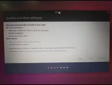

I am using Asus A541uj with Nvidia 920mx.
I got stuck (as seen in the image below) every time on "Updates and other software" during installation.
I created a bootable USB with Rufus & Universal USB Installer. Tried both GPT/MBR, DD/ISO, BIOS/UEFI, UEFI/Non-CMS in Rufus. Tried BIOS Settings Fastboot off/On, CMS On/Off (No other option is given in my bios) to no success.

with Nvidia cards you need to add nomodeset to the grub boot parameter. here is how to do that.
