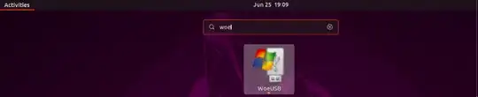

Please follow below commands:
sudo apt update
wget http://ppa.launchpad.net/nilarimogard/webupd8/ubuntu/pool/main/w/woeusb/woeusb_3.3.0-1~webupd8~bionic0_amd64.deb
sudo dpkg -i woeusb_3.3.0-1~webupd8~bionic0_amd64.deb
sudo apt install -f
launch it by searching the woeusb in applications.
