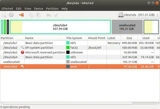

Here is how my GParted interface looks like:
gparted

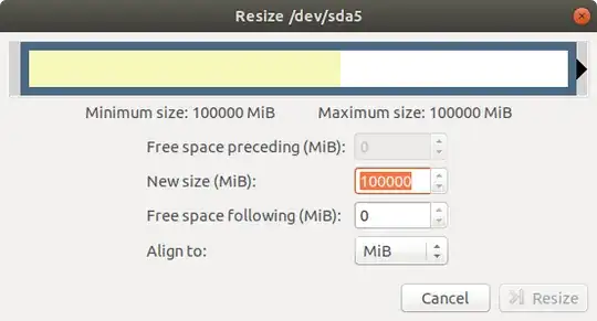

I want to add the unallocated space to my Ubuntu partition. However, when I try to resize/move I am not allowed to do so:
attempt

GParted doesn't allow you to modify partitions when they are active. Boot from a LiveUSB and launch GParted from there, it should work.
Senhara
  • 67
Make sure that you have a good backup of your important Ubuntu files, as this procedure can corrupt or loose data.
Keep these things in mind:
  • always start the entire procedure with issuing a swapoff on any mounted swap partitions, and end the entire procedure with issuing a swapon on that same swap partition
  • a move is done by pointing the mouse pointer at the center of a partition and dragging it left/right with the hand cursor
  • a resize is done by dragging the left/right side of a partition to the left/right with the directional arrow cursor
  • if any partition can't be moved/resized graphically, you may have to manually enter the specific required numeric data (don't do this unless I instruct you to)
  • you begin any move/resize by right-clicking on the partition in the lower pane of the main window, and selecting the desired action from the popup menu, then finishing that action in the new move/resize window
Do the following...
Note: if the procedure doesn't work exactly as I outline, STOP immediately and DO NOT continue.
  • boot to a Ubuntu Live DVD/USB
  • start gparted
  • move sda5 partition all the way left
  • resize the right side of sda5 all the way right
  • click the Apply icon
