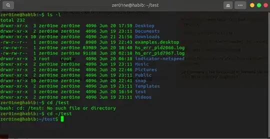

I used to use this command cd /Foldername to navigate the folder. But I am facing a problem with this now I need to use this command cd ~/foldername for navigating. Please have a look on the screen capture:
click here to view the image
The fact is how can I retrieve the old command? I prefer the old command.

When you navigate through directories, if you start with / the command cd interprets that it's an absolute path:
$ cd /directory
means (root)/directory, not /home/user/directory.
~ is an alias for /home/user
If you are in your home directory, and type $ cd directory (note there is no /), cd interprets as a relative directory, meaning reltive to your current directory.
There is a difference between the two commands.
cd /foldername changes your current working directory to foldername which lies directly under the root.
cd ~/foldername changes your current working directory to foldername, which lies under your home directory, which in most Linux distributions should be under /home/<your-username>/foldername.
Your error message tells you that currently there is no foldername under your root directory.
