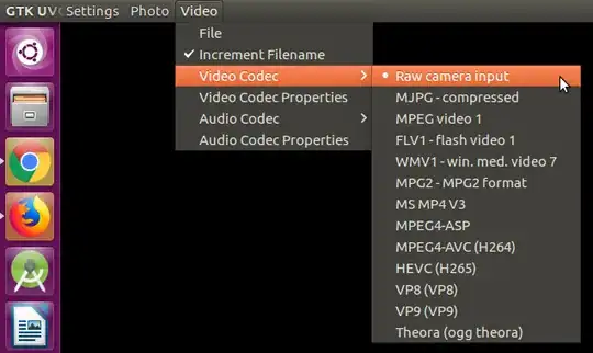

I figured out how to make it work with guvcview.
I found this post which mentioned that the issue was that guvcview was re-encoding the stream from the camera. Why that caused the horrible frame rate drop is a mystery to me, given that my CPU usage was extremely low...
Anyway, the fix is to tell guvcview to use the raw stream from the camera:

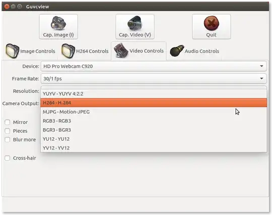

Please note that the format you tell the program to re-encode (or not) to is totally separate from the format you tell it to stream from the camera:
