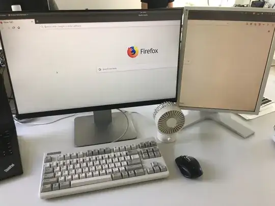

The display behaves like so: photo

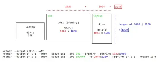

Calculate the full size of your framebuffer --fb, in my case, I want to use only my external displays:
diagram
First clear/rest xrandr settings
xrandr -s 0
Then turn off the laptop display
xrandr --output eDP-1 --off
Then position the primary display to 0x0, set as --primary and set panning to its own resolution:
xrandr --output DP-2-1 --auto --scale 1x1 --pos 0x0 --primary --panning 1920x1080
Then position the second screen to the right at 1920x0, set the framebuffer and rotate it accordingly:
xrandr --output DP-2-2 --auto --scale 1x1 --pos 1920x0 --fb 2944x1280 --right-of DP-2-1 --rotate left
