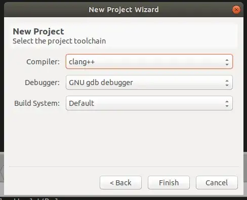

I have installed Codelite and I have g++ installed on my machine:
I've also used the following settings when creating a new codelite project
And I 've created a simple project

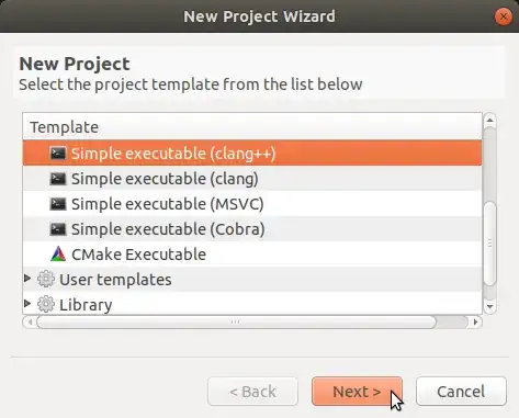

Install clang in 18.04 with the following command:
sudo apt install clang-6.0
Codelite
When you start a new console project select the Simple executable (clang++) Template. For Compiler (2 screens after the Select the project template screen) select clang(tags/RELEASE_600/final) or whatever clang version you have in the dropdown menu.
