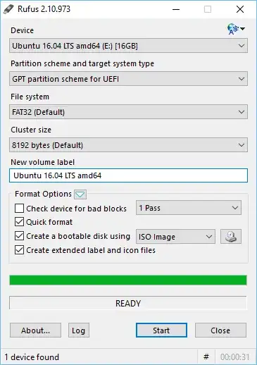

You should be using Rufus to create your installation medium.
be sure to configure it to use GPT and UEFI :
rufus configured in GPT and UEFI mode
leave it on Fat32
and things should run much more smoothly from there.
ideally, before rebooting to the ubuntu USB and installing, open up a powershell run as Administrator and type:
powercfg -h off
this will ensure hard drives are shutdown correctly and that they can be written to.
