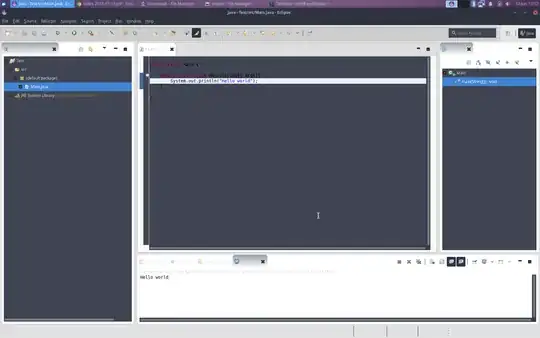

Ok so i am using XUbuntu and I like it because it's simple, looks great and works nicely on my 2gb ram laptop.
I also installed recently Arc Dark theme, and every other program, text editors or IDEs look great with it, except for Eclipse. I thought it was some type of bug so I installed an older Version that has like 5 Million Downloads but the problem still seems to be present.
Can anyone tell me what settings to change in the preferences to make it look as it used to? I mean, how do I make eclipse ignore the theme change of linux, and set everything back to white as it was.

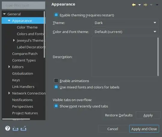

You should get a better display by doing this: in Eclipse, go to Window > Preferences > General > Appearance. Choose a dark theme for Eclipse and restart Eclipse. It should be in better harmony with your Xubuntu dark theme.
