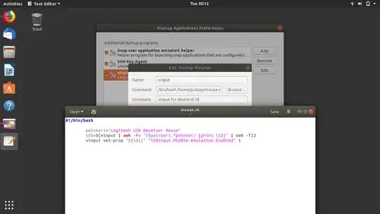

The thing worked for me is the below script
/home/user/mouse.sh
#!/bin/bash
    pointer1="Logitech USB Receiver Mouse"
    id1=$(xinput | awk -F= "/$pointer1.*pointer/ {print \$2}" | cut -f1)
    xinput set-prop "${id1}" "libinput Middle Emulation Enabled" 1
some of the Output of xinput
$ xinput
⎡ Virtual core pointer                      id=2    [master pointer  (3)]
⎜   ↳ Virtual core XTEST pointer                id=4    [slave  pointer  (2)]
⎜   ↳ ETPS/2 Elantech Touchpad                  id=11   [slave  pointer  (2)]
⎜   ↳ Logitech USB Receiver Consumer Control    id=16   [slave  pointer  (2)]
⎜   ↳ Logitech USB Receiver Mouse               id=18   [slave  pointer  (2)]
and added the command /bin/bash /home/user/mouse.sh in Startup Applications Preferences..
