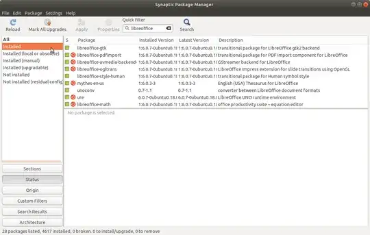

It's much less fatiguing to use a GUI application that permits you to keyword search and scroll so that you can view groups of packages containing the same keyword together, all of which are marked by a green filled checkbox if they are installed. Try searching for libreoffice in synaptic and you will see that there are many libreoffice packages in many different languages, but only the LibreOffice packages that are installed have a green filled checkbox. You can also narrow the search by categories such as Installed or Installed (local or obsolete) as marked by the mouse cursor in the left pane of the below screenshot.
Synaptic Package Manager
To install Synaptic in all currently supported versions of Ubuntu, open the terminal and type:
sudo apt install synaptic
To open Synaptic from the terminal type:
pkexec synaptic
You will be asked to authenticate with your user password in order to launch Synaptic.
This works most of the time if the package name is similar to its application name. If it isn't try this answer.
