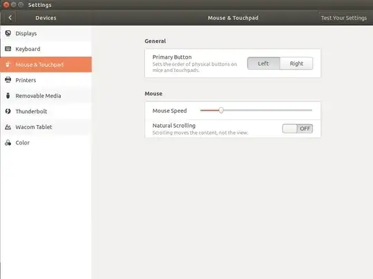

I disabled my touchpad from system settings and now there is no touchpad section there anymore.
here is the settings screenshot
Am i missing something?
output of xinput:

zom
-1
i used this to solve the issue: gsettings set org.gnome.desktop.peripherals.touchpad send-events 'enabled'
but still even after it comes back, if you disable from the settings pane, you have to use gsettings again to make it work!
