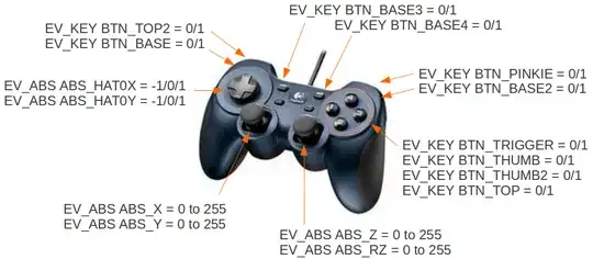

  3. Display names of every key, axis, button of the gamepad.
    The idea is to launch xboxdrv and test every button and note the result on paper.
    $ sudo xboxdrv --evdev /dev/input/event8 --evdev-debug
    Your Xbox/Xbox360 controller should now be available as:
    /dev/input/js1
    /dev/input/event9
    Press Ctrl-c to quit, use '--silent' to suppress the event output
    EV_ABS ABS_X 128
    EV_ABS ABS_Y 128
    In my case the result is:
    game pad with labels
  4. Set the config file
    Create an xboxdrv-mouse.ini file to set X Y axis and left and right mouse button.
    Here I set gamepad buttons 2 for left mouse button and 3 for right mouse button:
    [xboxdrv]
    evdev=/dev/input/event8
    silent=true
    [evdev-absmap] ABS_X=x1 ABS_Y=y1
    [ui-axismap] x1=REL_X:10 y1=REL_Y:-10
    [evdev-keymap] BTN_THUMB=a BTN_THUMB2=b
    [ui-buttonmap] a=BTN_LEFT b=BTN_RIGHT
    EOF
    Note that value for REl_X and REL_Y seems to define the speed of the mouse, and by defining a negative value it inverts the axis (see here for REL_Y)
    Another example with more button definition
    [xboxdrv]
    silent=true
    [evdev-absmap] ABS_X=x1 ABS_Y=y1 ABS_HAT0X=x2 ABS_HAT0Y=y2
    [ui-axismap] x1=REL_X:10 y1=REL_Y:-10 x2=KEY_LEFT:KEY_RIGHT y2=KEY_DOWN:KEY_UP
    [evdev-keymap] BTN_TRIGGER=x BTN_TOP=y BTN_THUMB=a BTN_THUMB2=b BTN_PINKIE=rt BTN_BASE2=rb BTN_TOP2=lt BTN_BASE=lb BTN_BASE3=back BTN_BASE4=start
    [ui-buttonmap] x=KEY_KPENTER y=KEY_SPACE a=BTN_LEFT b=BTN_RIGHT rt=KEY_KP8 rb=KEY_KP2 lt=KEY_KP6 lb=KEY_KP4 back=KEY_LEFTSHIFT start=KEY_RIGHTCTRL
    EOF
