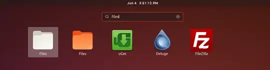

I recently updated to 19.04. When I search for files in the dash, I have the following result:

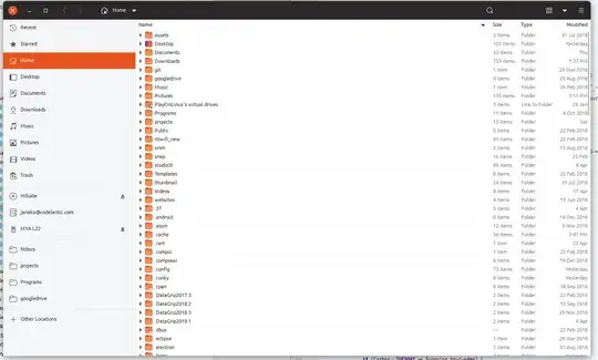

The white one points to the default app:

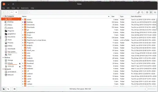

And the orange one to:
The problem is the default app sometimes does not load. The other one always loads.
What is the difference between these two? How to fix the issue of the default one not loading?

You have an additional file manager installed in addition to the default file manager, nautilus. The appearance of the screenshot makes me suspect that the second one is nemo. They are different file managers, but they have similarities. That is because nemo actually has been based on nautilus many years ago, and then has continued its own development. These file managers are deeply integrated into the system. It is not a good idea to have them installed together within the same desktop environment.
It is difficult to troubleshoot the "sometimes non starting" issue. Having also nemo installed could be part of the issue, but there might be other issues with your current operating system.
