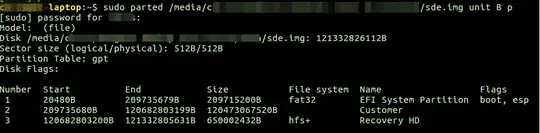

I managed to open the laptop, attached the disk to a linux machine and copied the disk partitions using dd if=... of=.... However when I have a look at the partitions, dd does not list any file system for partition #2 (which is the biggest and should contain the data) and I can't manage to get it mounted. enter image description here

Any ideas on how to read the data on partition #2? Is this normal behaviour of mac file systems, to not have a type when shown in parted/linux? Can I get more information about the file system somehow? Or might it just be encrypted/damaged? Right now I'm only doing random guesses on what's preventing me from reading/mounting the data.

I solved mounting the mentioned partition by installing/following the instructions here: https://github.com/libyal/libfvde/wiki/Mounting.
It seems that the issue was that it was a FileVault encrypted partition (password was the user account login password of the macbook - but I'm not 100% confident if this is always the case or the user of this macbook just picked the same password for both).
hint: also make sure to get the .wipekey file that is mentioned in the github repository in the exact same way that it is explained there. At first I did it in another way, which gave me "unsupported core storage signature" and some other errors.
