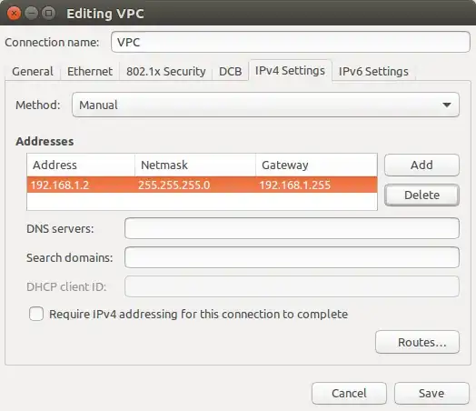

When it was 14.04 and 16.04, connecting the two computers directly with an Ethernet cable was a straightforward matter. I'd set static IPs via an dialog like the one below and I'd be ready.

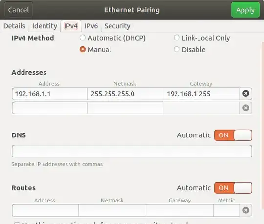

It's not as straightforward with 18.04, apparently. Before my attempt to pair the two computers with the cable, I was using a Wired connection 1 to connect to the Internet on the 18.04 machine -- I'd just plug it in and I'd be online in seconds. After the pairing attempt, not only were the two machines not seeing each other on the private network as I was expecting, but Wired connection 1 is no longer connecting to the Internet when I switch to it.
Here is the dialog I'm struggling with on 18.04. As can be seen, it's different from the first image which is the dialog on both 14.04 and 16.04.
So how do I do it?
UPDATE: My intention is to connect the two computers together to arrange a fast transfer of files between them. Attempting to connect to the local network on the 18.04 machine throws an error Connection failed Activation of network connection failed.

Brief outline for an alternate way to accomplish file transfers, without cable and connection profile changes, and more...
  • connect your phone to the 18.04 computer with bluetooth
  • on 18.04, open nm-connection-editor and create a new ethernet connection profile
  • go to the IPv4 tab and enable "Share to other computers"
  • go to the 16.04 computer
  • create a standard ethernet connection profile with dhcp
  • connect an ethernet cable between the two computers
  • note: you may have to reboot one/both computers at this time
  • enable Folder Sharing on one/both computers (use the Public folder if you wish)
  • transfer files using drag and drop
  • reach the Internet from either computer
note: you may have to install dnsmasq-base in 18.04 to get this all to work
