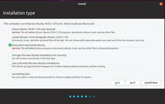

Erase and Install (by @user68186)
When you start the fresh install of Ubuntu 19.04, you should see an option to erase everything and install. This will remove all the partitions and create new ones spanning the whole 2TB.
Image provided by user68186
This option will delete everything in that disk! That means Windows, Ubuntu 18.10, any data partition, any recovery partition etc. etc.
