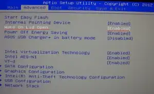

No. It has been around for a while: I would assume it is the "wake on lid-open" feature some computers have. It is a setting in the BIOS. Maybe you inadvertently activated it?
Random example from the web:
