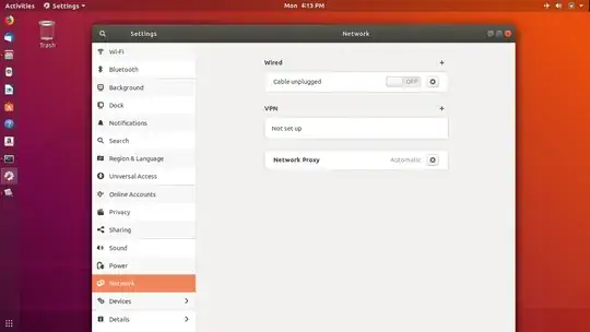

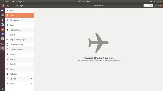

I am using Ubuntu 18.04 in my HP Pavilion DV4 laptop. After installing it shows that airplane mode is on by hardware switch
and there is no airplane mode disable switch I found in network
as a result WIFI and Bluetooth not working

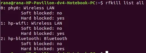

When running rfkill list all

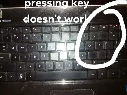

Also when I run on widows and press F12 airplane mode is on and off but in Ubuntu it doesn't work
So how can I disable airplane, enable WIFI and Bluetooth
After a long read and research, I discovered the issue is with acpi=off as a kernel boot parameter.
  1. Edit your kernel boot parameter with:
sudo nano /etc/default/grub
  1. Look for the line with GRUB_CMDLINE_LINUX_DEFAULT="quite splash acpi=off" <--parameters may defer based on your system - ->
Within the " " (quotes), replace acpi=off or any other acpi parameters with acpi_osi=!.
e.g.: GRUB_CMDLINE_LINUX_DEFAULT="quite splash acpi_osi=!"
  1. Press Ctrl+O to Save and Confirm Change
Press Ctrl+X to return to terminal
  1. Update grub with :
sudo update-grub
  1. Reboot your machine.
Everything should be working fine. :)

My wifi does not work after installing Ubuntu on an HP Pavilion DV-4 Laptop, I found that the touch switch that used to turn wifi off and on now toggles it into and out of airplane mode, I think that is the manual switch the system is referencing. At least it was for me.
