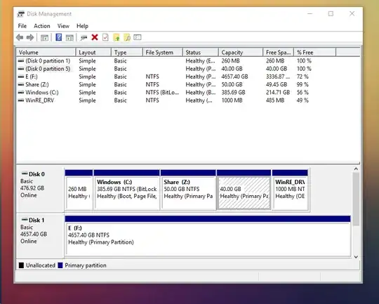

I'd allocated 40GB for the Ubuntu partition, and don't save anything substantial there barring a couple GB movie files in the last couple days, without issue, so I wouldn't expect the recent install of texmaker would have changed things, even at 1GB+. Checking Windows disk manager shows 100% free, not sure whether that's good or bad (partition 5):

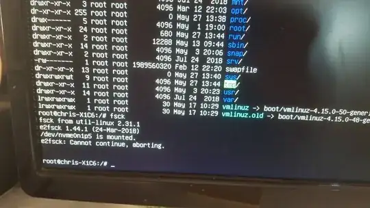

Edit 2: I was able to boot into recovery mode and get to a terminal. fsck, dpkg, and clean all fail to resolve the issue. fsck aborts with '/dev/p5 is mounted, aborting' message.

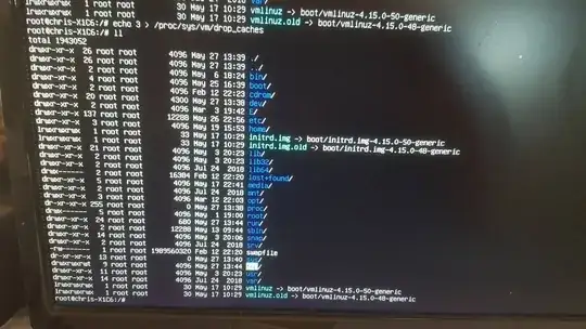

I've included a picture of the error fsck returns as well as one of ll showing memory use (and the offending swapfile).
