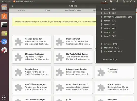

Go to the standard Ubuntu Software, press Add-ons and go to the Shell extensions TAB. Find "Sensory Perception GNOME Shell Extension."press install.
All temp sensory info are shown next to the clock.
Works perfectly out of the box after a fresh install.
