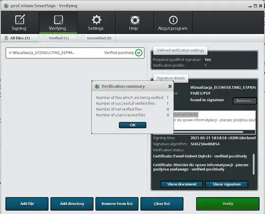

I am using procertumSmartsign app that verifies signatures compliant with European eIDAS standard in PDF, XML (both internal and external signatures) and any other files (external signatures):
https://www.support.certum.eu/en/cert-offer-smart-sign/
Please note that European eSignature hierarchy is different than in other parts of the word.
