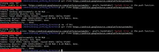

The error appears only occasionally, e.g. the first repo sync checked out 90% of the projects successfully. Here is a screenshot illustrating the erratic behavior of the error: enter image description here
Lastly, I am using WSL with a proxy so there is plenty of room for strange issues.

Found the problem, my proxy resolved to 1 of 2 IP addresses. One of them worked without issue, the other did not.
