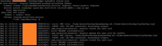

I have added the following crontab job:
sudo crontab -e
58 * * * * ubuntu /home/ubuntu/backup/mysqlbackup.sh
>/home/ubuntu/backup/log/backup.log
I have tried both root and ubuntu users.
When I run the command:
sudo crontab -l
And when I run:
systemctl status cron
But mysqlbackup.sh is not executed. Any idea what is the problem or how can I diagnose what is going wrong?
Note I have added only minutes to test the script

58 * * * * ubuntu /home/ubuntu/backup/mysqlbackup.sh >/home/ubuntu/backup/log/backup.log
This is incorrect format.
The format is described in the crontab file:
  # m h  dom mon dow   command
ubuntu is not a command. Remove it, so the line reads:
  58 * * * *  /home/ubuntu/backup/mysqlbackup.sh >/home/ubuntu/backup/log/backup.log
Systemwide crontab, specified in /etc/crontab has the user field:
These files also have username fields,
# that none of the other crontabs do.
# m h dom mon dow user  command
