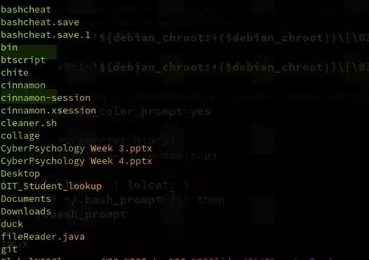

I am using lolcat to get the output of ls in color. To do this i have copied /usr/bin/ls to /usr/bin/lsslss (to avoid an endless loop since alias cannot acccept $* or $@) and I have added the function:
ls(){ lsslss $* | lolcat; } to .bashrc
The issue is that when i use ls the pipe is piped each file at a time so it shows up as a long list like this:

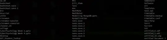

instead of a table like this:
to change it into a table I can pipe the output into columns command. but when I do it changes back into a long list (probably because of columns only formats it instead of changing it into rows)

When its output is piped, ls disables the column listing. Use the -C option to explicitly enable it:
ls(){ COLUMNS="$COLUMNS" command ls -C "$@" | lolcat; }
COLUMNS="$COLUMNS" sets the COLUMNS variable correctly to the current terminal’s width, without that it defaults to 80 – try resizing your terminal window and compare the outputs. command ls serves to ignore aliases and functions and call ls wherever its executable is. Note that I used "$@", to quote the Bash Hackers Wiki:
