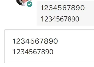

Some programs make the distinction very clear, for instance vi: enter image description here
... but other programs (most importantly firefox) make almost no distinction:
That leads to very incompetent-looking messages. When the customers look at the message above in their Mac browsers the distinction is super-clear.

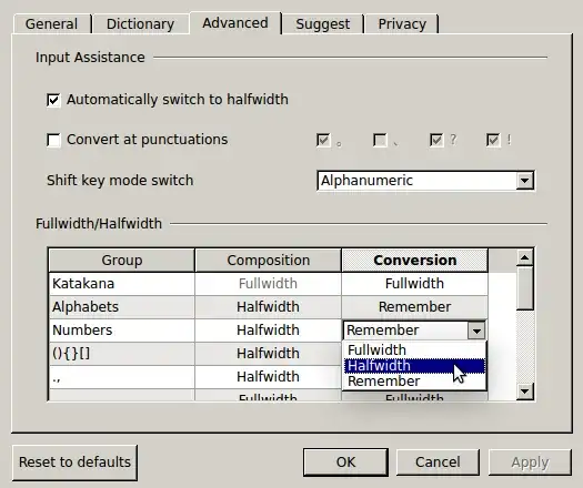

This is an example how you avoid to type in a full-width characters, especially numbers.

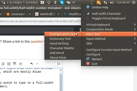

This is a mozc configuration panel; advanced tab from which is brought by this way.
There're many other input methods and should be set by different ways but almost always the same, e.g. Anthy or ATOK, Windows IME and etc.
